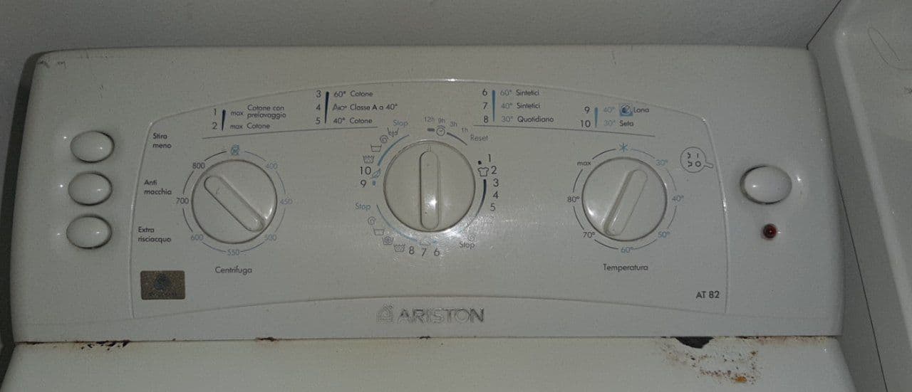

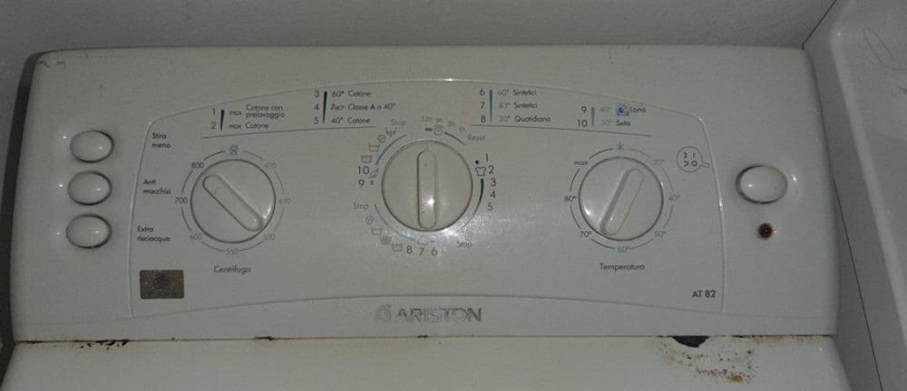

betty2345 Inserito: 23 aprile 2021 Segnala Share Inserito: 23 aprile 2021 hello, i have problem in using AT82 ariston washing machine. is there any manual available? i wanna know hot to reduce the time of washing and what is appropriate foe washing ordinary clothes Link al commento Condividi su altri siti More sharing options...
Stefano Dalmo Inserita: 23 aprile 2021 Segnala Share Inserita: 23 aprile 2021 http://i.manualretriever.com/lect.php?ID=4691320&lg=I&h=d41d8cd98f00b204e9800998ecf8427e&src=15 Open the link and click of download Link al commento Condividi su altri siti More sharing options...
UABC80 Inserita: 23 aprile 2021 Segnala Share Inserita: 23 aprile 2021 (modificato) Hello! Did you try to search the manual on the Hotpoint site? I see that in the Italian version of that site there is a copy of the manual, but it's obviously wrote in Italian language… I'm not familiar with that washing machine, but washing time can be normally influenced by setting low water temperatures and/or too high doses of detergent. Furthermore, if the washing machine "perceive" that the load is unbalanced, it could extend the time of the spin cycle a lot In order to suggest you the right program for your clothes, we should know which kind of clothes they are. The better thing to do is to read the clothes labels and set the washing machine accordingly. For example, resistant cotton tablecloths can be usually washed by setting the program #3 at 60 °C, synthetic clothes can be washed by setting the programs #6 or #7, wood clothes can be washed with the program #9 and silk clothes can be washed with the program #10 Since "Quotidiano" means "Daily", the program #8 should be a sort of "jolly" HTH Modificato: 23 aprile 2021 da UABC80 Link al commento Condividi su altri siti More sharing options...
