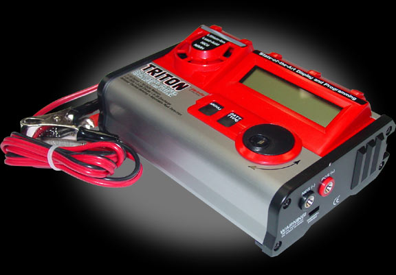

Carica Batteria Al Piombo 12v 3ah
Innanzitutto saluti a tutti!
Ho un caricabatterie da modellismo che mi permette di impostare l'amperaggio di carica e tante altre cose....
carica un pò tutto...batterie al piombo, ni-mh, li-ion, nicd, lipo .....
si arresta da solo quando la batteria è carica...solo mi chiede l'amperaggio di carica...e non so quanto dargli!
La batteria è una al piombo da 12V e 3Ah
a..mi permette di impostare fino a 5A a passi di 0,1A!
Per chi lo conoscesse è questo...
FEATURES
- Handles just about any battery you throw at it. 1-24 cell NiCd or NiMH cells (1.2- 28.0V), 1-4 Lithium-ion or Lithium-polymer cells (3.6- 14.8V) or 6, 12, and 24V lead-acid batteries (Pb).
- Up to 10 different battery configurations are storable for instant,
easy recall and charger set up.
- Features adjustable peak detection sensitivity, and recalls data for up to 10 full cycles.
- Top-off charge feature fully charges NiMHs without overheating.
- The scrolling dial offers simplicity and sophistication in its programming. - Warning messages for improper input voltage, poor connections, unsuitable battery condition, and reverse polarity on output.
- Safety features include cool-off time delay, maximum NiMH charge input, fast charge safety timer, current overload, and reverse polarity protection.
- Optional battery temperature monitoring allows you to safely and accurately charge heat-sensitive Lithium-ion, Lithium-polymer and NiMH batteries.
- Built-in cooling fan for better charge efficiency and longer charger life.
- One year warranty.
- Input Voltage: 10- 15.0V DC
- Adjustable Charge Current: 0.1-5.0A (2.5A maximum for Li-ion/Li-po).
- Fast Charge Current: 0.1 -5.0A linear (2.5A maximum for Li-ion) (1A for Li-po).
Fast Charge Termination:
"zero deltaV" peak detection with adjustable sensitivity for NiCd and NiMH batteries.
"constant current/constant voltage" for Pb & Li-ion Li-po (cc/cv)
optional fast charge thermal cutoff (thermal probe included)
TRICKLE Charge Current:
0-250mA (n/a for Pb and Li-ion/Li-po), automatically set by Triton (not user adjustable) based on the level of the peak charge current.
Discharge Current: 0.1-3.0A
Discharge Cutoff Voltage:
0.5-1.16V per cell NiCd & NiMH (0.8V j cell fixed during cycle)
Pb fixed at 1.8V per cell
Li-Ion/Li-Po fixed at 2.8V per cell
Output Connectors: banana jacks
Input Connectors: Alligator clips
Case Size: 6.2"x 4.0"x 2.0" (157 x 102 x 51mm)
Weight: 16.4 oz. (466g)
Modificato: da mrburton
Tieni presente che in generale le batterie ,o meglio gli accumulatori vanno caricati al massimo a 1/10 della corrente nominale (quella che compare scritta sulla targa ).
Paolo Cattani
In realtà non è vero, ma 1/10 è la corrente convenzionalmente consigliata, quella che dovrebbe garantire la maggiore durata della batteria. Un normale alternatore auto, ad esempio, ricarica a più di 1/3 della corrente nominale.
Io starei fra 1/10 ed 1/5, cioè da 0,3 a 0,6 A.
